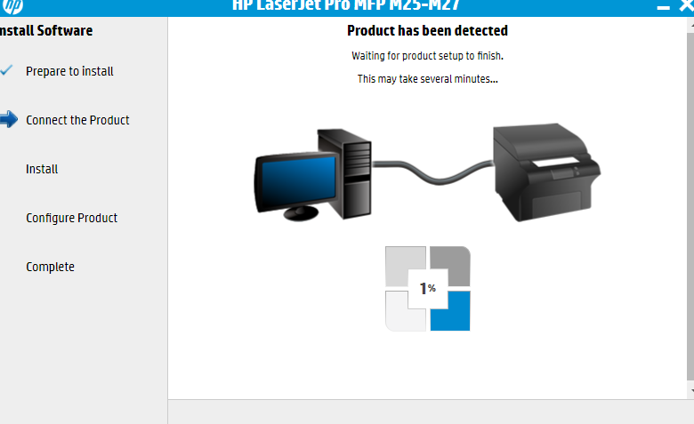

I proceed to install the driver to setup a USB connection but still failed. Below are the screenshots. Please advice.
It's weird if Windows 7 doesn't support this driver. I have tried both online package and CD, both doesn't work.
1.PNG2.PNG3.PNGUSB connectionUSB connectionConnect cable when toldConnect cable when toldstart processingstart processingwhile the software is still installing, we got this errorwhile the software is still installing, we got this errordive in to have a lookdive in to have a lookfrom 1% to 99% took about 15 to 20 minutes. And the software load at 99% for about another 15min before it throw an error (see next screenshot)from 1% to 99% took about 15 to 20 minutes. And the software load at 99% for about another 15min before it throw an error (see next screenshot)error!!!!!!!!!error!!!!!!!!!

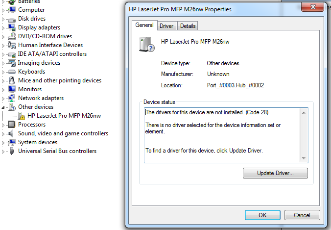

Thanks for the detailed informatiom, it seems as your operating system incorrectly staging the drivers..
Please run the installation once again and plug the USB once prmpt to do so.
Once you plug the USB and the printer appears in the Other Devices category, right click the printer name and select Update Driver Software.
Click Browse my computer for driver software.
Click the Start button and type %temp% into the search bar, then open the shown Temp folder.
Open the latest HP installation folder which begins with 7z (e.g. 7zs1234)
Left click the top address bar white area and then its path will be highlight, right click it and select Copy.
Return to the Update Driver windows within the device manager and paste that address, press Next and follow the steps on screen. it should now update the printer and allow the installation to continue.

Hi,
1. The %temp% doesn't have the folder that you mentioned.
I followed the steps strictly and once I connect my USB when told to do so, I go to %temp% and didn't see any folder mentioned. Please see below screenshot.
2. I have also tried myself manually download the basic driver and hope to get it installed using deive manager, but also cannot work! 😞
