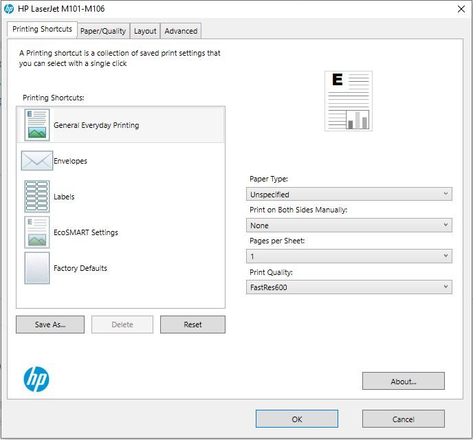

It say HP LaserJet M101-M106 PCLm-S. But it's not using it because it wouldnt install thats why its using the generic windows print driver. See the printer preference difference.printer preference.PNG
Its not even detecting the printer driver.
