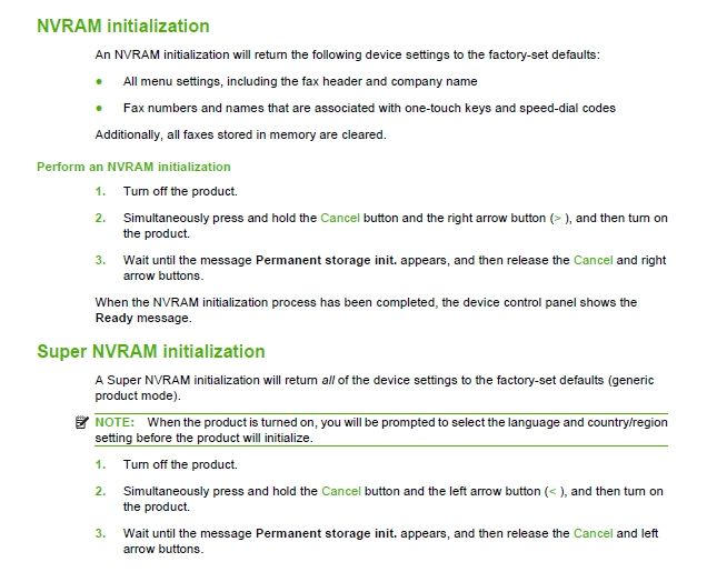

'Firmware Corrupt Ready 2 Download' Error. From reading other comments, it appears that I need someone from support to send me the steps to perform an NVRAM reset in a private message, as they did here. https://h30434.www3.hp.com/t5/Printer-Software-and-Drivers/MFP-M277dw-Ready-2-Download-fw-is-corrupt...
Google and download HP LaserJet M2727 mfp Service Manual then NVRAM is inside.
if after NVRAM it's still no work then you need to try to resend firmware through USB cable, if you can't see any firmware updating processing on the panel you'll need to change the connect port from USB001 to USB002 003 004...... one by one until one of them will work and you can see the difference on the panel. The connected port is in the printer property by right clicking the printer icon.
If after succeeding firmware updating and reboot M2727 you still get the 'Firmware Corrupt Ready 2 Download' Error then you need to change the formatter.
