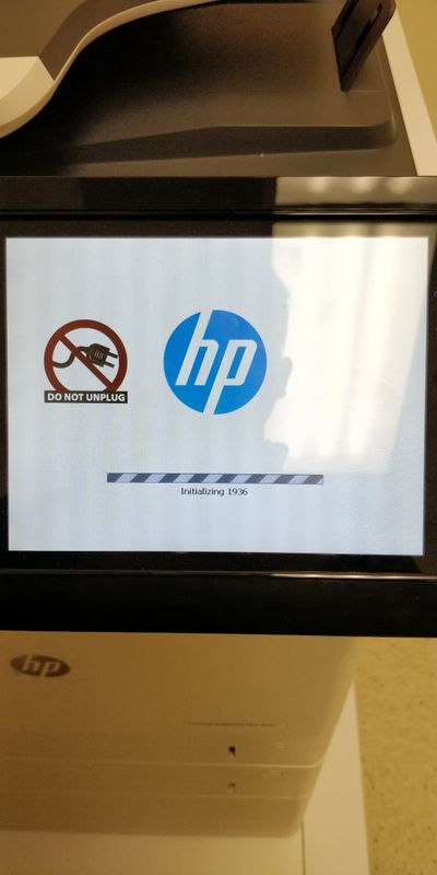

Can anybody facing this Problem with HP LaserJet Enterprise MFP M725f Printer, Printer is not Continue Booting and getting Stuck upon processing the
"Initialization 30"
I thank you in advance for those who can help me to solve this issue
Kindly see the attach Snapshot taken form the Printer Display.

The first step would be to go into the pre boot menu and do a partial clean.
The partial clean will wipe the active partition including any data on it and then when the printer finishes booting it will reload that partition from the backup partition.
To get into the pre boot menu power cycle the printer and tap the HP icon when 1/8 appears under it.
You will also see a full clean option which will wipe the hard drive and the machine will need to have the firmware reloaded from USB Drive before it will work again. You do not want to use this option unless the partial clean does not help.

15513105803881623209088373004965.jpgwhen I first saw this screen, the number was somewhere around 1830, it's gone up to 2000 when I'm typing this. This had been going on for a couple hours today . Can you tell me what I could do to fix this issue?
Thanks
