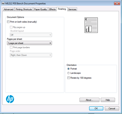

I can not get the printer to print double sided. Please let me know who I can print double sided.
Thanks
1 REPLY 1
Specs do not state that this unit supports duplex automatically so your choice would be manual duplexing which requires you to manually refeed the paper after printing the first sides of the document. When you select the printer you want to print to you click properties and then finishing and select manually duplex. Unit will print all first sides and then prompt you to reload paper to print second side. Follow the instructions to ensure you load the paper the right way up.
