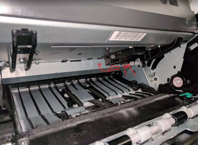

I had this problem with a LaserJet M605 and the fix was the little connector inside the printer that makes contact with the toners 2 copper terminals.  When I looked in the printer (with the toner out) there was a small spring loaded piece of plastic hanging which seemed to not push the connector all the way forward to make contact with the toner.  The plastic piece looked like a little T upside down.  I pushed in and up and it snapped back into place.  The attached picture shows what it should look like.  There should not a T hanging when looking in the printer toner cavity.  I think someone was too sloppy / aggressive with replacing the toner and it popped the springloaded connector out of place.  Hope this helps someone else.
This is what is should look like...
