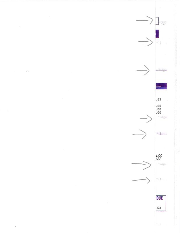

Here are some examples of what it is doing. Thanks!
99% sure that will be fuser. The ghosting is what gives it away. That is the fuser not getting hot enough and it picks up some toner and redeposits it on the paper on the next rotation.

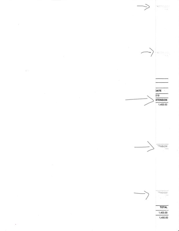

I have a similar problem based on the description  - using an M477.  See the attached image my printer is putting out as of just today.0001.jpg
