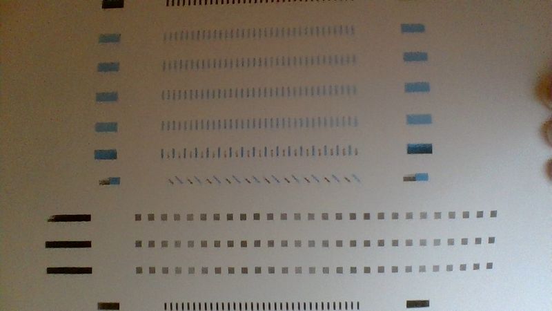

Recently out HP Envy 7640 when it prints smears, and cuts off random letters while printing, I tried all of the recommendations, including a three step ink cartridge cleaning, two alignments, and a smear fix built into the printer, I also shut off the printer, and did a hard reset but nothing is working, the alignments also are failing.WIN_20190917_16_44_47_Pro.jpg

I tried that. I'm thinking something may have been screwed up when we moved from NJ to Florida, I have tried litteraly everything HP recommends, including the built in cleaning, alignment, and cleaning the cartridges, it feels almost like what a old type writer would do when the head was broken, or the actual ink dried out, so I think it might be that.
Well, it was the ink cartridge, it dried out, and I just installed it maybe a month or two ago.
@CooperChurch1 Does that mean the issue has been resolved after replacing the ink cartridge? If not, we could attempt a reset too,
