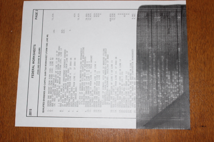

While in the middle of printing a 24 page document, the printed pages went from perfectly legible to totally black (Coal Mine Black).  The cartridge is only about 2 months old and has plenty of toner.   I removed and reinstalled the printer, but the problem remains.  To me this looks like a hardware (circuitry) problem at this point.  Thanks in advance for any tips on further diagnosis.
Thanks rb11, I have done those things (support page, etc.) and the problem persists.  I might add the image of the first page that turned totally black while printing.  Hopefully, I can attach a jpeg file illustrating how quickly the page went to total black.  IMG_3491.JPG - Start of totally black printing
Hi @JackAndDiane,
Thanks for getting back to me. Thank for including the JPEG. I can see exactly what you are talking about.
If you have gotten through all the steps in the support document, I suggest contacting HP Tech Support by phone as they may have some additional resources available that may help lead to a solution for this issue.

There is good news and bad news to report on this issue.  The good news is that the LaserJet 200 is now working correctly.  The bad news is that a 2 month old toner cartridge failed causing the problem.  Purchased through Amazon, the failed cartridge was just outside (by 2 weeks) their refund/replacement window!  On a whim, I thought what the heck, let's try a fresh new (HP of course) toner cartrdige and voila, problem localized to the old cartridge itself.  It would be nice if HP would be interested in doing some failure analysis on the failed toner cartridge.  It would be even nicer if they compensated me for what probably was a manufacturing defect. (At least I can dream  :OpenSmile:  !)
