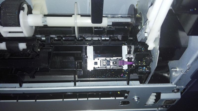

We have just fixed that. The issue is equal for a few models but the solution is different. I will show you pictures with 3 sensors which made the problem. On the first picture sensor is behind plastic. You have to remove it to clear it. Other two pictures are also showing problematic sensors.
