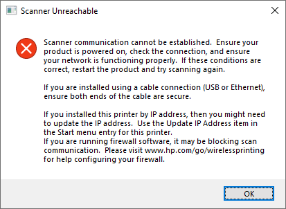

Printer works good. But scanning problematic.
Made fixed IP address, connect on wifi from windows 10 64bit pc (is wired lan connected pc on same network as wifi).
Found HPScan.exe buggy and seems "HP scan and capture" app on ms store is more stable, but now can not save scanned documents as pdf. Still can save as jpg. When try to save as pdf, is created pdf file on desired disc location with size 0 KB, but after moment removed and app notice "Failed to create pdf".
also tried NAPS2 and HP scan extended, but these never scan, can not connect to scanner. Tried various settings.
Bundle HPScan worked some time ago, but was problematic to establish connection with scanner. After reinstalling via HP scan and printer doctor removal process - do not work any more. Produce error in launching "scanner unreachable" with some delay and close.
Any ideas?
I mostly use to send and archive documents. Scan to pdf multipage with 150 dpi.

Hi robot,
nope.
It is dedicated to print question, but I'm asking about scanner.
Same here.
Also rerun scan and print doctor, went with errors. Only application connect to scanner is from windows store "HP Scan and capture". But still can't save scanned documents as pdf (single or multiple), only can as jpeg.
Tried to scan from printer to gdrive - very complicated when scan from flat glas: no option to scan multiple pages and very loooooong pauses between separate pages, printer connecting to web app, waiting, choose options and scan, waiting till uploading, etc. Very disappointed. seems only scan from feeder is usable. But feeder also stops, probably while current document trasmit is finished.
some hp print and scan doctor screens.
Any advice?

thanks, that worked 🙂
Only problem was, that ms store do not alowed to download, but changed region to UK and voila.
This time printer was installed as MFP and other programs, like NAPS2 also can scan. Now on printers and devices on control panel right click show scanner options. Before was only printer properties/preferences and no scanner.
