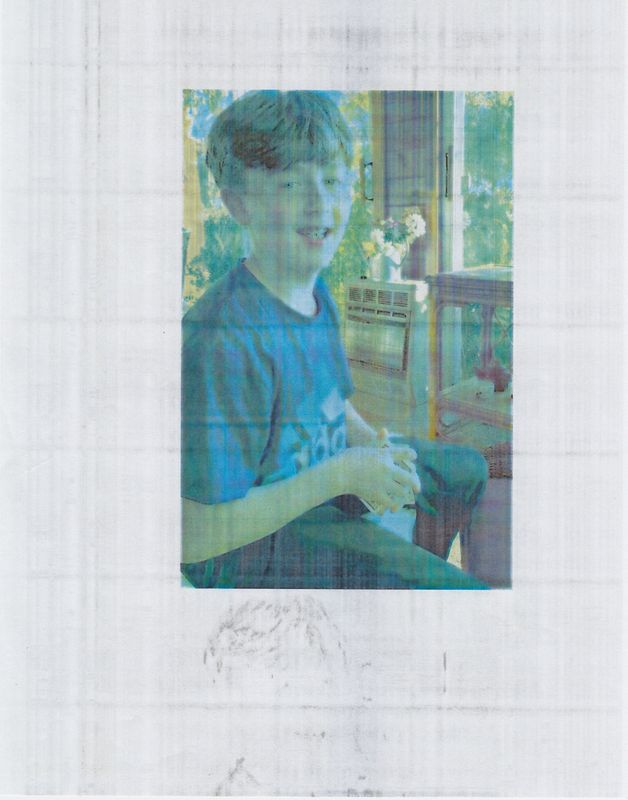

MY printer quality poor, it is printing both sides of paper at same time. It look like double image .back of pageback of pageFront of pageFront of page

The double image is caused by either the drum unit or the fuser.  From the looks of your prints there is likely cartridge issues at play here with the amount of background shading I am seeing and the poor color. Actually surprised to see one of these machines still running. They had a heavy appetite for fuser assemblies unless the user was willing to put up with the common banging of flattened pressure rollers.
repetitive defect chart (measure between first defect and second), see chart below for component causing the problem.
