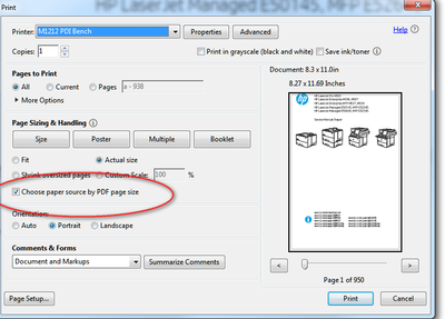

There are several possible issues here. First, make sure that the hardware settings on the printer are correct, if you have plain letter, you must set the paper type and size to plain letter. Secondly, on the print driver, make sure that the default paper size set for tray 2 is plain letter. I have seen cases where the driver defaults to HP eco paper or A4 sized paper, which results in that tray not being selected and Tray 1 asking for plain letter. Thirdly, when printing from Adobe, ensure that you do not have the "select paper source by PDF page size" checkmarked (see picture below). This can cause issues when trying to print a document that was created with a computer that uses standard paper sizes tha differ from yours. For example A4 if a document was created in Europe.

To manually check the settings instead of using the Doctor do this: On your PC go to control panel>devices and printers and then right click on the icon for your printer and select "printer properties" from the drop down menu. Click on the preferences button in the bottom left of the window which will open up user defaults, click on printing shortcuts and set the paper size there.
You can also click on the Device settings tab and set the paper sizes there as well.
