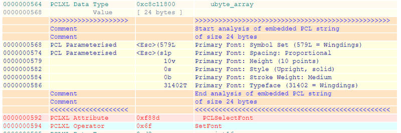

Not as such, although PCL XL Class/Revision 3.0 does include the PCLSelectFont attribute to the SetFont operator.
The attached .zip file contains a sample print file (and an analysis of same) which:
  • Prints the characters 'acbde' using the Arial font as selected using standard PCL XL font selection.
  • Prints the same characters using the Wingdings font as selected using its PCL characteristics, via use of the PCLSelectFont attribute.
The analysis shows the difference between the two font selects:
But very few printers support this attribute; 'sending' the content of the sample print job to some locally available printers yields the following results:
  • LaserJet 1320n fails with a PCL XL "UnsupportedProtocol" error - this is because this printer only supports PCL XL C/R 2.0 (not 3.0).
  • LaserJet pro 400 Colour MFP M475dn fails with a PCL XL "IllegalAttribute" error - this printer appears to be a hybrid, in that it supports C/R 3.0, but not all of the more obscure additions introduced in that update.
  • PageWide Enterprise Colour 556 prints the data as expected:
... and use of such sequences is almost certainly not supported by 'standard' drivers, so this presupposes that you'd be generating your own (PCL XL) print jobs without use of such a driver.

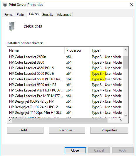

The reason why PCL Paraphernalia fails to generate any output on your (USB-connected) LaserJet M180 may be associated with use of "v4 printer model" drivers (although I haven't had time to investigate this yet).
With the older "v3 printer model" drivers, 'passthrough' of raw (printer-specific) data is achieved with the 'raw print data' solution by specifying a datatype of RAW.
But with the newer (XPS-based) "v4 printer model" drivers, 'passthrough' appears to require use of a datatype of XPS_PASS.
If the printer were connected instead as a TCP/IP Ethernet network printer, and the PCL Paraphernalia Target configured as a Network printer, this issue is not relevant, since the  'transport' mechanism is different in this case (it doesn't require any knowledge or use of Windows drivers).
To check whether the driver is a v3 or v4 version:
  • Open a command-prompt session.
  • Type printui.exe /s and <enter>.
  • This should start the Printer Server Properties dialogue (you may be asked to provide an administrator password).
  • Select the Drivers tab - this shows all installed drivers (even for printers which you may no longer have installed); for example:
Thank you for your 26th March reply giving a method of establishing whether the driver is V3 or V4.
Around March 20th, I noticed that there was a new version of HP software for my printer and so I have downloaded and installed it. I have previously also installed the latest firmware 121017. Therefore I cannot confirm that the previous printer driver was v3 or v4.
When I ran Printui it confirmed that the current driver was a v4 printer driver.

However when I send PCL5FontSelect to the generic/text driver, the following text is printed:
PCL XL Error
            Subsystem:     KERNEL
            Error:               IllegalAttribute
            File name:       kerlib.c
            Line number:   4556
This looks like it is the same response as your LaserJet pro 400 Colour MFP M475dn.
And your comment on that was “this printer appears to be a hybrid, in that it supports Class/Revision 3.0, but not all of the more obscure additions introduced in that update.
I suspect that there is no error handling for printer errors with the generic text but at least it works with Paraphernalia.
There is another peculiarity of this second driver for the HP printer. It does not show up in Devices and printers but it is available if you try to print from Word or Notepad.
I will try to release an interim version of PCL Paraphernalia to address the "v3 versus v4" issue.
[I'm working on a new tool (edit of PCL and PCLXL bitmap fonts), but (at the current rate of progress) it will be some time (and I may never complete it - getting old and tired!]
The IllegalAttribute error is almost certainly because your printer (like my M475dn) does not support the rather obscure PCLSelectFont feature.
I can't really help with your new printer instance not showing up in Devices and Printers, sorry.
