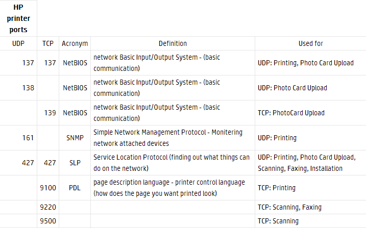

Have you made sure that all these ports are open on the network :
Also, do you feel that this may be related to your network structure?
