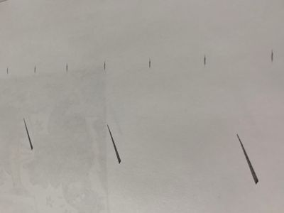

Cannot answer for sure without seeing a sample but if the marks are repetitive and evenly spaced you can measure and use a repetitive defect ruler to determine the cause. Usually either a cartridge or the fuser.
troubleshooting manual with defect ruler here: https://www.laserpros.com/img/manuals/hp-manuals/hp-lj-m203-pro-mfp-m227-troubleshooting.pdf

Ink stains appear on the back of paper.
This can be caused by a recent paper jam. If a paper jam is not detected immediately, the printer may continue to print. When this happens, the ink from cartridge is sprayed on the bottom of the printer instead of the paper
