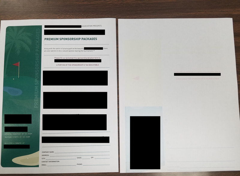

I am a computer lab monitor at a university and we are running in to an issue with our LaserJet CP4525 wherein it seems to grab two pages for every print. The first page prints the intended page of the document just fine, and the second page prints a copy of the same page as a very faded, off-centered copy. After each print it throws the code "41.7" which I have been unable to find online for this model of printer.

An example of the faded copy printed with each page.An example of the faded copy printed with each page.

The other probable possibility is a sticking paper pickup solenoid that sticks too long and causes a second paper to come through and getting the residual image off the belt for the faded print and causing the error. These printers have problematic paper pickup solenoids where the foam pad cushion on the solenoid becomes old and the adhesive begins to soak through the pad and causes the solenoid flapper to stick allowing a second paper to be picked and fed through. It can be modified or replaced, but is difficult to get to. This usually happens on single page prints or after the last page of a multi-page document where there isn't any time delay between pages printed.

The faded image copy is not the same image registration as the original, which means the paper was not sent through intentionally. This strongly reinforces my theory of a sticking paper feed solenoid.
