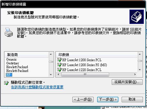

Dot4-001 is not a printer's name but printer's port connected to PC.
Add a new printer manually and select port Dot4-001 (not automaticly found by Win 10-it won't work) then find LaserJet 1200 in HP's list menu.
We don't use English here in Taiwan and speak Chinese and I'm not good at English.
What I post next is in Chinese XP system you can compare it with your English Win 10.
Hope it helps.
OK. I'm close.
Printers & Scanners
Add printers & scanners
Add a local printer or network printer with manual settings
NEXT
Use existing port
DOT4_001
NEXT
Unfortunately my LasetJet 1200 is not listed in the HP menu list. Should I select an alternate printer? Should I use "HP Universal Printing PCL6"?
Should I select "have disk" and the insert my old HP driver CD?
