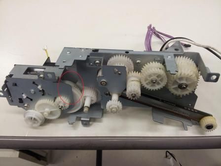

Try to clean ITB area by compressed air - ITB sensor is located on right side below ITB, if not help, you have to fix fixing drive assy (RM1-4974-030CN) - problem is in solenoid on this drive, replace or fix it by cleaning and aplying tape on flag area

    remove fuser drive assembly and correct gear alignment. check solenoid download.jpgy5qboQx.jpg
The solenoid that clicks on and off and turns the transfer belt and drive gearing is the issue.
Not the belt , or the left front sensor.   The solenoid is in a unit that is BURIED in the printer.  In the drive assy.
I took one apart to verify.  Problem is getting it out , cleaning the sticky substance that causes it to stick , then getting it back
together.  If not a pro , this may be too much to do and get it back together.
Anew belt is expensive and if fixes it , will reoccur since that usually isnt the real cause.
[edited]      HP service for 20 years so take heed .  Another machine may be the way to go.
