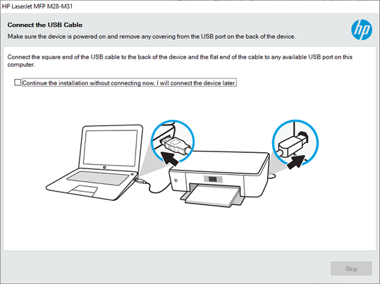

Hi Shlomi,
I dd not get the same screens as you. Following the extract and the start of the installation  the following screens are shown (I have ignored the screen about unpacking the printer).
I do not see the same screens shown in your previous message.

Thanks for clarifying Steve, I do believe that this is due to a conflicting incorrect software installation as I thought.
Please carefully follow the below steps:
  1. Click the Start button and select Settings (gear icon) once again.
  2. Click Apps and type HP again.
  3. Uninstall the HP Laserjet MFP M28-M31 Basic Device Software and the HP Laserjet MFP M28-M31 Help software.
  4. Be sure to delete any such instance if there are several, I do suspect you may have more than 1 instance installed on your PC, as from your screenshot order it seems exactly as the order it should be shown when the HP Software is already installed.
