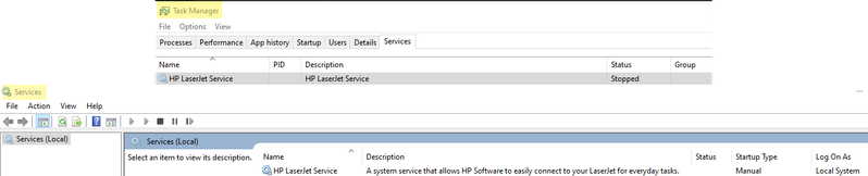

I have the M252DW on the network and print via wifi. I do not print often.
The HP LaserJet Service is causing my CPU to spike really high when I am not using it. It is also has high network usage and again I am not using it.
Why is it doing it and how do I get it to stop?
I have stopped the service in my task manager, and was able to print, so I do not understand why this service is even running.
Windows 10 Home v1903

The issue is with the HP Laser Jet Service running on my computerI stopped the service and put it in manual mode. I am still able to print wirelessly to the printer without an issue.
