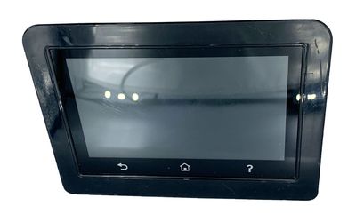

My display looks different thant thatone, but I will try anyways.
Below is how my display looks like
 regards!!
You need to hold this area then power on and keep holding.  If that does not work you may have an issue with your control panel.
