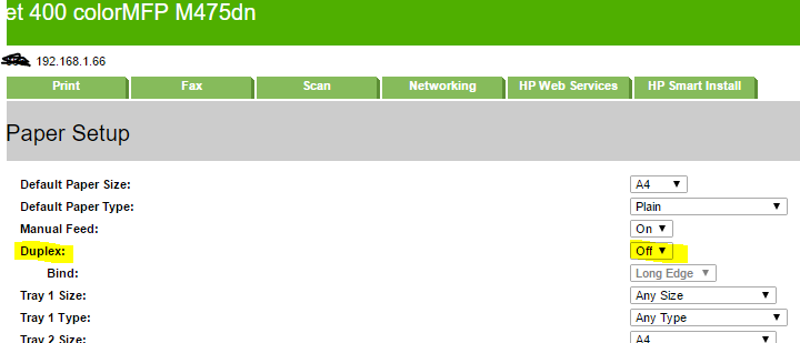

Symptoms suggest a driver fault - perhaps it does not set the 'plex' requirement for simplex print jobs, nor set the processing boundary for multiple copies?
If we 'captured' (via 'print to file') a sample print job, then analysed the resultant .prn file, we could confirm (or not) this diagnosis, although it would then merely confirm (or not) a driver fault.
You may (not sure) be able to circumvent the problem by changing the default duplex mode on the printer (assuming that it is currently set to 'On').
I don't have access to a M476DW device, but it is probably similar to LaserJet 400 Pro M475dn:

10-26-2016 09:00 AM - edited 10-26-2016 09:01 AM
>> ... I will try this but doesn't look like it a workable solution as this is beyond the remit of our users ...
You'd only need to change this setting once (per printer).
As far as I'm aware, the problem:
- Only affects simplex print jobs, (some of) which do not include the appropriate 'set simplex' instruction - in which case the duplex = Off setting on the printer should come into effect.
- Will almost certainly not affect duplex jobs, because these jobs do include the appropriate 'set duplex' instruction - in which case this will over-ride the printer default of duplex = Off.
