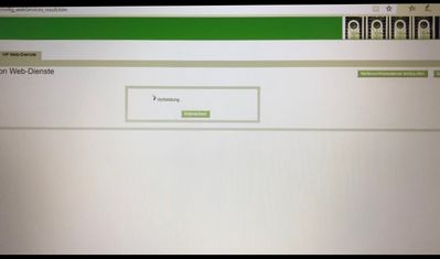

Hi,
I am on the end of my way to reactivated my PRO M12w with HP ePrint. I don't konw why I lost my conections. I had Restart and reset my Printer and Restart and  reset my Fritz.box AVM Router, too. But I don't reactivate my (Webdienste) ePrint Service, when I activate my ePrint he lost the Connection to the HP Server and the failure Massage say that my Printer is offline. But when print  the Test/Status Page is the Printer online and with my Laptop I can Print with WLAN.  My first Printer Claim (Berechtigungscode) is lost. the last page I have Print was in 01.2020. By my first activation I have Change the Printer-email Adress but this Adress is not found in the Database from HP when I used HP Smart APP. And a new Printer Can't I Register, because I can'tactivate my Printer. All Help Threads have I read and have all finshed, BUT my Printer get no Connection to HP, but he is online. And when I send a MAil to my normal Printer Mail Adress, get I the HPePrinter Mail, but only my Printer is silent.
What could I do now?
Is my Printers Connection tool broken? Has HP stop the Support for this Printer?
THanks Joerge

Hi Jay_24,
 Thanks for your help, but all the steps I have finished befor I ask here in this Community.
My Printer is online, I can Print from My Laptop In My WiFi, I can get into the Printers EWS with the IP Adress. But when I will activate the Webservice it’s load, but After 3-4 Seconds I get a failure Massage that My Printer is offline, The Blue Wifi LED glow stable at this moment.
The Printer had  get the Last Firmware, and was reset at delivery Status.  But I get Every
 Time that My Printer is Not Online.
your steps are for My Problem Not the Solution I Need.
thanks
AHOI joerge

Hi, thanks
It dosen‘t work.
The Printer is in the 2,4 Hz Network and online, but I get every time a failure that he is Not connected.
 thanks for your help and Ideas
Ahoi joerge
J. Bernhardt
