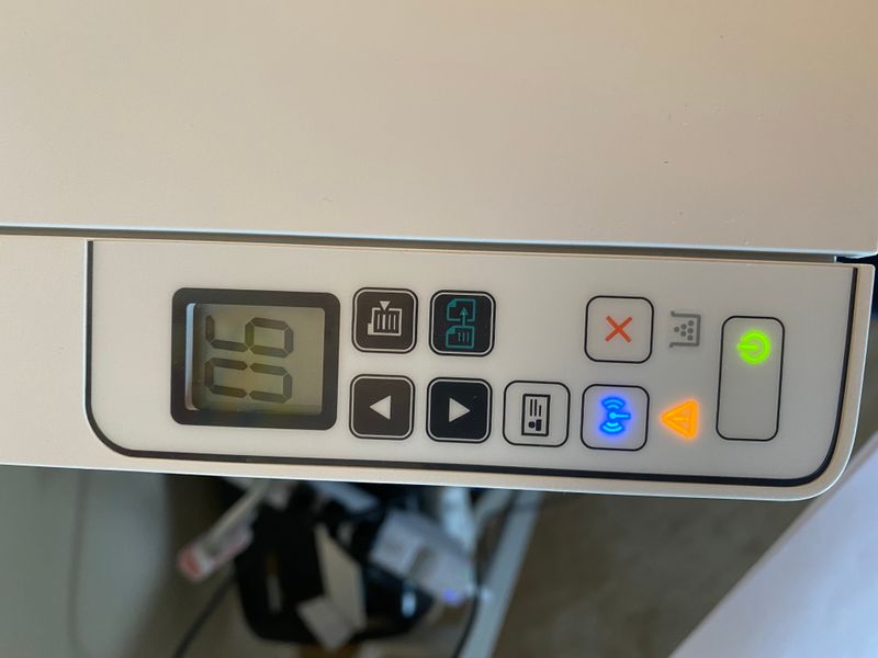

a piece of paper jammed on the inside of my Laserjet mfp 29w and I tried to pull it out but it ripped, and a piece is now stuck internally. I've unplugged the printer, powered off, etc, but still get the Error 6 message. How do I get to that internal piece?!?!?!??!

 If you could take a photo of interior of the printer and post here so we can see maybe someone will give you some help. Removing a torn piece of paper is always a tricky job.
You have a camera icon to insert photos from your computer.

Hi, thanks for helping me. I know you can't see the paper, but it's in there. It's very tiny.

Got it the piece of paper out! I was looking for it in the roller, instead, it was stuck up higher in the feeder. Thank you so much for your help!
