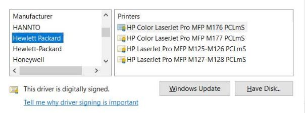

I have gone through all of the steps you provided and then some.  Nothing works.  My printer driver doesn't show up.  I have attached a snip of the choices I have.  Mine is the Pro MFP m183fw.  It's not there.  I don't dare just guess.

What do I do now??  I just don't understand why it was so easy to install on computer 1 and is such an issue with computer 2.  I will say that computer 2 has an SSD where all programs are stored.  I don't know if that makes a difference or not, but just thought I'd mention it.
Looking forward to your next response.

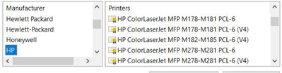

CatLady001, I had this same issue, except my printer is a CLJ3800. I followed the steps posted like you did, and didn't find my printer listed. Until I scrolled down in that list you posted. There should be another printer group listed below Honeywell, plain old "HP". My printer driver was located there. I'm not sure why there are 3 different groups for HP. But there are. Good luck.
Thank you for your response.  I did as you said and my printer isn't in that list either.  Here's what I see:
Since mine is the MFP m183fw, you can see that it's not there.  Here's another section of options:
It's not here either.  It's simply not offered.
I'm at a total loss now.  Nothing I'm doing is working.  I need a viable solution.  I'm at my wits end...  😞  HELP!!!
Did you try the driver for the  MFP m182-m185 PCL-6(V4) listed in HP?
To me, that says it's for models m182 thru m185. I would try it before following your other option.
Good luck
All the letters and numbers following the ones that are right tell me that it’s a different machine.  I thought about trying it, but then I didn’t want to dig myself a deeper hole.  What makes you think this will work?
