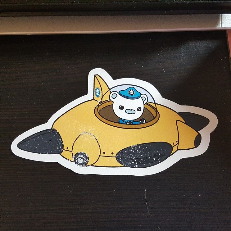

is there a way to fix the color printing on this printer? My images are coming our missing pieces.  My other laser printers prints on this same paper stock just fine.  Not sure why this printer is having issue.  Please help! Thanks!
Looking at the print it seems that you will have to change the paper type setting on the printer.The fuser unit is not fusing the paper correctly.Maybe also calibrate the printer before Printing these pictures.Hope this will help.

Thank You so much! It was my user error.  I changed the setting to Extra Heavy paper type and it prints so much better now. Thanks for the support. Now I understand my printer better now.
