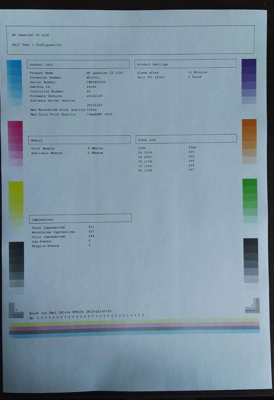

When I try to print any colored image it always comes out in shades of yellow, no other colors.
However test page prints all colors fine, displays all cartridges at 100%.
So I know it's software issue because my cartridges are ok. And it printed fine 3 months ago.

Test pages below

How is this related to my issue? Printer on the video has wrong colors on test page. My test page is fine, all colors present. Printing of actual images is broken.
