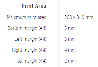

The specification page for the LaserJet Pro MFP M127fw shows some details (for A4 paper size):

The specification page for the LaserJet Pro MFP M125nw shows some details (for A4 paper size):
This seems to be exactly the same as for the M127fw model.
According to both those specification pages, the bottom 5 mm of the A4 page is in an unprintable region.
