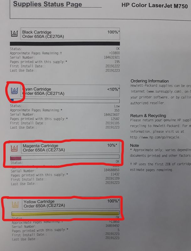

When i take color print out some shadows & misaligned format is printing. if i take black print it is working good.
i have attached the quality  of prints.what is the problem and why is it occurring and how to fix it?Shadow and misaligned print only on colorsShadow and misaligned print only on colors
2 REPLIES 2
Are there any events in the error log? The registration sensors could be dirty or faulty and this would show in that log. Also the very low cartridge could cause issues with alignment if the images printed during calibration are not dark enough.

I changed new cartridge,ITB,upgare firmware also upto date.but stil there is same problem.
