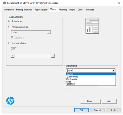

I am not seeing the option to set Date and Time as a watermark. This is what I see on my screen.
It also doesn't give me the option to shift the watermark like it does for you. I'm not sure if this is because the driver is not updated or if it's because I am not accessing the actual UPD driver the same way you are (though I don't think that's the case, because it says UPD version 6 when I go to the "about" tab. Seen below).

You need to update to a more current UPD.  Your revision looks like 6.0 and current is 6.8.

Thank you. I will have to contact IT and see if this is possible. Like I said it's a work printer and computer, so only IT can do updates/downloads like that.
