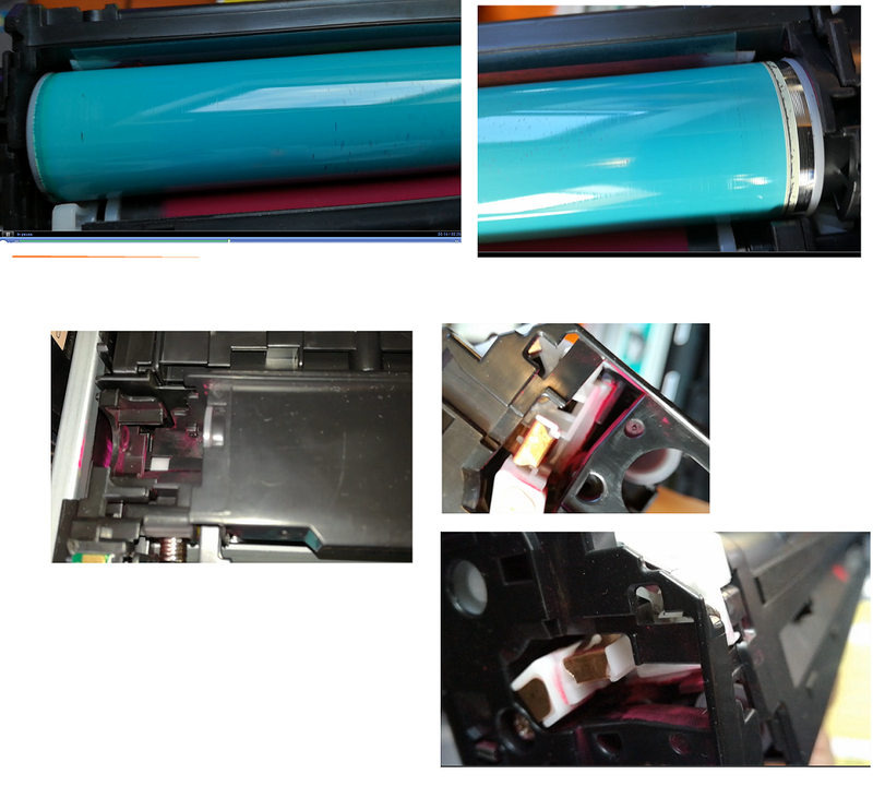

some rollers / drum are clearly scratched on the sides
(the photos represent the state after I cleaned them externally a little but not completely, to show the dust out)
I also found black powder and magenta scattered in the front and especially back doors, as seen in the photos (a lot on the transfer belt)

YELLOW Cartridge
MAGENTA Cartridge
BLUE Cartridge
BLACK Cartridge
TRANSFER BELT (CHINGHIA DI TRASFERIMENTO)

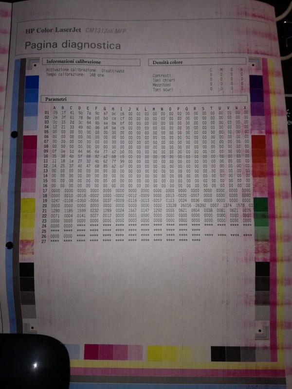

TONER CARTRIDGE STATUS OF CHARGE
AND PRINT TEST

The transfer belts are self cleaning so if you change out the cartridges it should take care of itself. There may be residual toner dust on the pages that you first print after changing the cartridges, if that's the case it should go away with the more pages you run. But changing the cartridges should take care of it and like I said, the ITB is self cleaning so it should be fine.

That's not normal, they look like cheaply built reman cartridges. Judging by your pictures the Magenta cartridge is leaving the most shading, I'd start with replacing that first.

I have seen cartridges cause damage to the ITB but it’s been few and far between. I imagine that if you change the cartridges it’ll be just fine.
in fact you could see from the photos, how ITB is dirty with magenta dust?
it's almost colored, does this mean I have to clean it?
or changing toner with others, can I leave ITB like that?
my fear is that it does not look so colorful / dirty with dust
