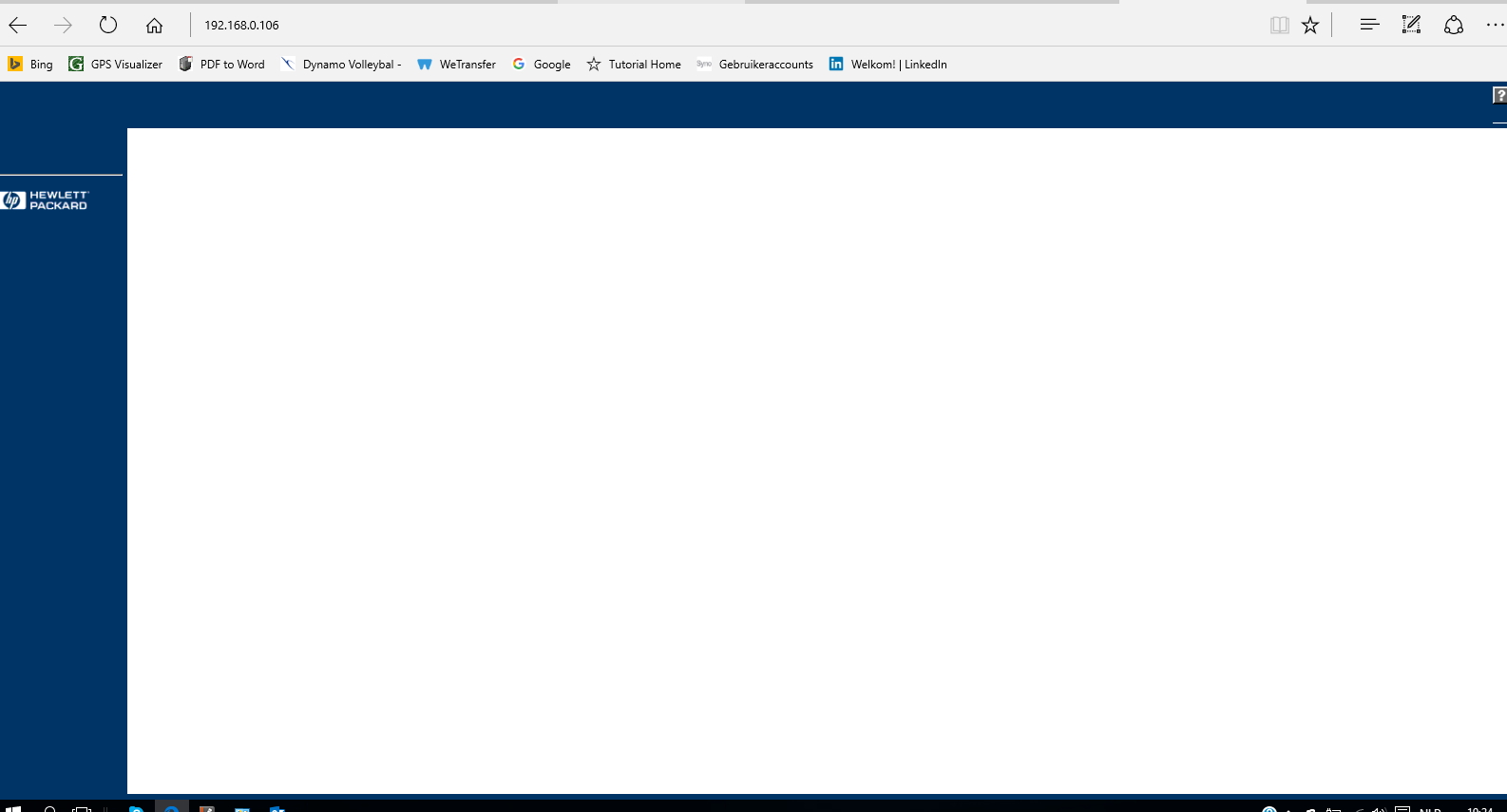

I have a laserjet 2100TN and a jet direct J3110A tot connect it with my network.
My goal is to change the IP adress because I want to have a static adress in the network. To do so I try to open de the internal settings page of the printer via de IP adress 192.168.0.106. All I get is blanc screen with only the "help"button and a link to HP.com. How can I change that?

You may be out of luck unless you have a very old computer with win95 or 98.  Your problem is the 600N network cards java interface is very old so newer computers can not load java to access the information.  Sometimes an xp computer can read the card but most times it will not.  What you can try is to use the host name of the jet direct card which appears on the same page as the ip address of the config report.  Since the host name never changes it does not matter if the ip address changes or not.  You could also do a search of the hp web site for a program called install network printer which will use hp software to find and setup your printer where the ip address will not be important.

The suggestion that the internal settings can only be reached by using an older version of JAVA is correct. I managed to install a 6.45 JAVA version on an laptop with Windows XP (SP3). With this combination it is possible to reach the internal webpage of the HP 2100 TN laserjet (with the jet direct 600N). So I succeeded in changeing the dynamic IP adress of the printer into a static one. How I found my way to this result can be read HERE. Regrettably it is in dutch so for all you Yankees it may be a bit of a puzzle :LaughingTears:
