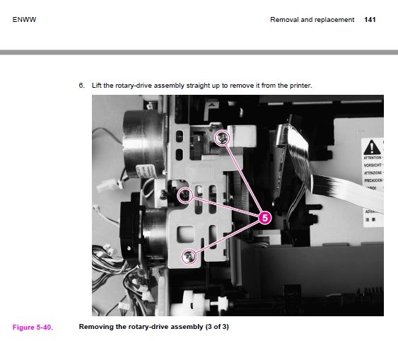

It's the so called "Sticky Solenoid" problem which is an easily happened problem.
You'll need to take left,right,top,back cover off and formatter case then you can get to it - the Developing-rotary-stopper solenoid.
It's not a hard job to it but you may need a service manual and google for it. (HP 2550,2500,1500 all be fine)
On YouTube find "HP 2500 color only prints yellow".
Just put a V-shape paper in between those two metals to keep them sticky again and that will be done.
There's no need to take the solenoid off from the main frame you'll just need to find an easy way to insert the V-shape paper into it and it'll be done.
