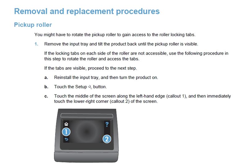

Your issue is not a jam but the pickup roller is worn and can not pick up the paper and the printer thinks there is a jam when the paper does not reach the registration sensor in the time alloted.
Replace it will be done.
Or you can try to clean it first by taking it out and clean it by using soap water, you can change the grabbing surface in the mean time since you have taken it out. But it won't last long enough by doing that.
Another way is to slow down the print speed of  CM1415 by changing the plain paper types from normal to heavy.
You can change all else paper types to heavy too this should  help it last for a long time enough until one day it'll fail again then you must have to change the pick-up roller.
You can do all these from a browser and key-in IP address -> System -> Paper Types.................

I apologise for my late response. The courier service lost my pickup roller package! Anyway, I was a little bit sceptical about the solution because its 7years old printer and the first page always runs without a problem.  Finally received it and replaced. Printing has never been smoother before now! Thank you for your help. Appreciate it.
