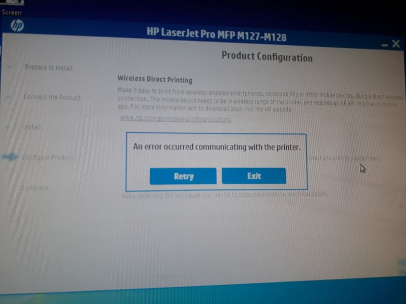

Screenshot showing what happened while installing HP Printer driver.Screenshot showing what happened while installing HP Printer driver.
Thank you dear for your support though it didn't yet solved my problem. The above picture shows what happened installing the driver. And, after installing I tried to print from MS Officie and PDF file but I can't print it. Furthermore, there is no printer icon in Device Manager.
