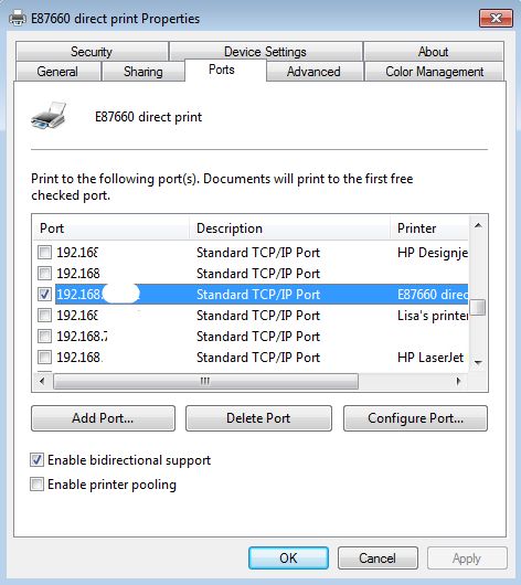

If you are having a printer offline issue that can often be caused by the type of port that the print driver is configured to use. Windows loves to set printers on WSD ports. These have proven to be less than reliable. The most reliable connection method is to give the printer a static IP address and to use a Standard TCP/IP port as the port type for the driver on your computers.
To check your ports, on your PC go to control panel>devices and printers and right click the icon for your printer. From the drop down menu select Printer Properties, then click the port tab. A WSD port be WSD followed by seemingly random numbers. TCP port appears as in the picture below. Note I have edited the displayed ports for security.
Yours would typically be something like 192.168.1.51
If you find the information provided useful or solves your problems, help other users find the solution easier by marking my post as an accepted solution. Clicking "yes" on "was this reply helpful" also increases the chances that this solution will help others.
I am a volunteer, offering my knowledge to support fellow users, I do not work for HP nor speak for HP.
Thanks to you, I’ve just begun to learn about the ports, & how to determine what port is being used!  After I ran Scan Doctor 5.0.5, two entries were created in “devices, printers & scanners”.  For the “HP Color LaserJet Pro MFP M477fdw (A3AD71) (copy 1)”, Ports shows a TCP/IP entry and the printer offline issue was cured.
