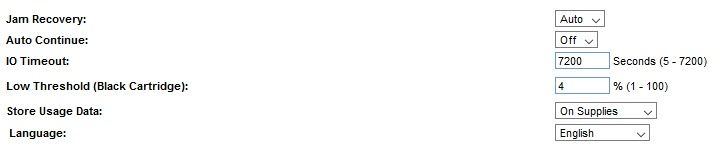

attached is a photo of my setting in the eco smart console.  changed setting to
1 hr. (sleep/auto off)
i also changed the io timeout to 7200 instead of 5...
this only because I had a note from the last tech support agent's work last year.
Todd, you may wish to verify what that setting should be.
All appears well.
I did some Google search and the default for the i/o timeout default on other HP printers is 15... so I changed it to that.  Thanks for the input on the ecoSMART setting.  PB
