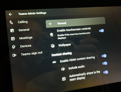

When in Teams mode, Microsoft previously did not transmit audio from HDMI.
This is thankfully changed, but you need to enable audio in the setting on the Teams Rooms.
On the TC8, go to:
More
Settings
Device settings
Admin Settings
 - sign in
Teams Admin Settings
General
 - under content sharing, make sure to: Include audio
That might help
Thank you for your answer.
I have checked this parameter, but "include audio" is checked indeed.
