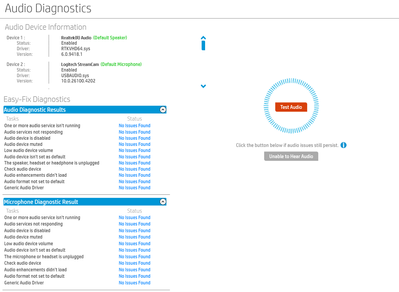

06-03-2025 09:36 AM - edited 06-03-2025 09:38 AM
@Garp_senchau
Additionally, I reran the manual quick fix. It shows no issues, but I still hear no sound when I press the Test Audio button. Then I press 'I still hear no sound,' and after that, it works. But only until tomorrow, and then it starts again, and I have to do the same quick fix over and over again. That shouldn't have to do this daily, should I?
I have copied the details below.
Thanks for your help,
Kind regards
Annie
06-06-2025 07:45 AM
@Annielira, Thank you for sharing those screenshots — and I completely understand how frustrating it must be to wake up to silence on your laptop every day.
From what you've described — especially that sound only returns after manually running the fix — it sounds like the system's audio service or driver initialization is getting disrupted during startup. Even though the diagnostics say “No Issues Found,” something behind the scenes clearly isn't behaving as it should.
Let’s try one change that may help make this fix stick:
Disable Audio Driver Power Saving (Realtek)
Sometimes, Windows puts the audio driver to sleep too aggressively:
Press Win + X and select Device Manager.
Expand Sound, video and game controllers, right-click Realtek Audio, then click Properties.
Go to the Power Management tab (if available), and uncheck “Allow the computer to turn off this device to save power.”
Click OK and restart.
Set Startup Type to Automatic (Audio Services)
Press Win + R, type services.msc and hit Enter.
Scroll to Windows Audio.
Double-click it. Make sure Startup type is set to Automatic.
Do the same for Windows Audio Endpoint Builder.
Restart your PC.
If you’ve already done these, or nothing changes, this might point to a deeper glitch in the Realtek driver config or registry entries. At that stage, a clean reinstall of the audio driver using HP official driver from the HP support site could help clear out any lurking conflict.
Hope this helps!
