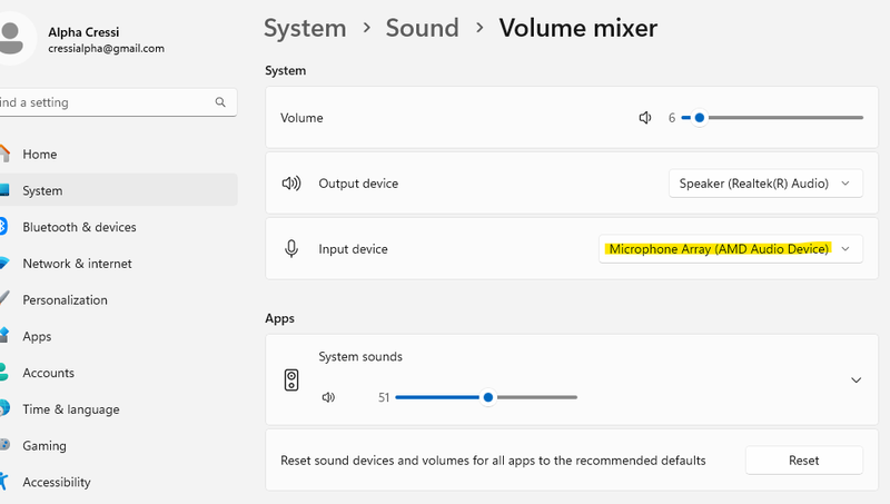

Hello. Thank you for all your suggestion but it did not work. I explain what I did for fixing the issue.
  1. I have enabled to see hidden devices, but no Microphone appeared.
  2. I have already downloaded manually the drivers (https://support.hp.com/id-en/drivers/hpdiaclosure/hp-17-laptop-pc-17-cp2000/model/2101251640) and installed them but nothing has changed.
    I did it again today but nothing.
  3. I entered the BIOS but there is nothing regarding Audio settings.
  4. I run the HP UEFI Diagnostics but since it does not detect anything, the test can be performed only if I plug an external microphone in the left jack 3.5mm port.
After restarting the PC again, then I opened the Device Manager again and it appeared a "Microphone Array (AMD Audio Device)". It's enabled.
However, if I run the Sound Recorder app, I see the microphone device on the bottom left, but if I click record it's not recording and then it crashes.
The "nice" thing that the "Microphone Array (AMD Audio Device)" disappear from the device manager list!
I noticed an issue under the "AMD Audio CoProcessor", so I tried to have the driver update but it's answered that the last drivers are installed.
So, I searched on the Internet and landed in this page: https://www.amd.com/en/support/download/drivers.html
I downloaded the package, and an AMD Software Installer started to download some unknown packages.
I am not sure that drivers for a graphic board would solve the audio issues, but I heard some sounds during the installation.
In any case, the "Microphone Array (AMD Audio Device)" reappered.
Then, tried again with the Sound Recorder, it recorded my voice, but the volume was very low.
I have increased the volume of the microphone and finally I can say that it worked!
Then, I am not an expert, but it seems the microphone is AMD and not Realtek, right?
Thank you for the support.
Cressi

Hey @Cressi,
Great to hear the microphone is working now! And yes, based on your troubleshooting, it looks like the built-in mic is handled by the AMD audio drivers rather than Realtek.
Thanks for the update and the detailed steps
