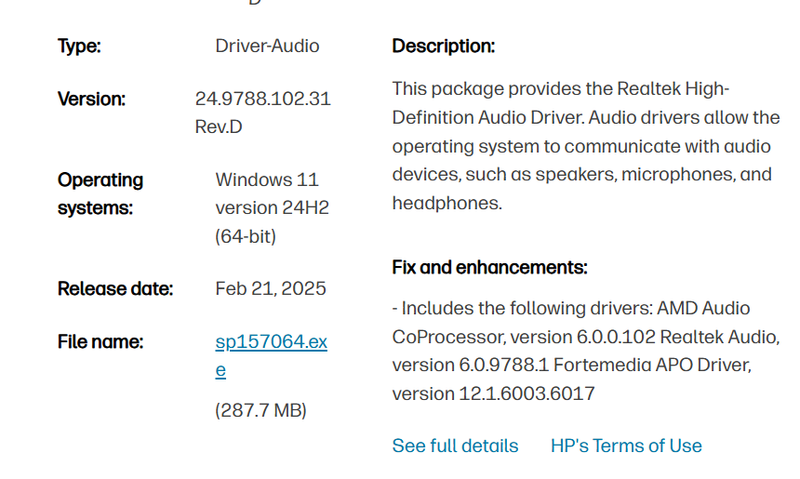

This wouldn't even let me update the drivers...thanks anyway.
