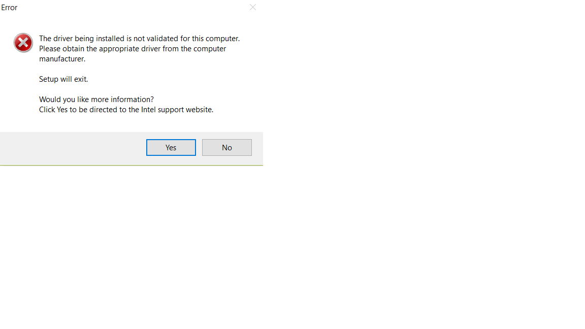

I tried to update the graphic driver which is Intel High-Definition (HD) Graphics Driver file sp72370.exe  There was an error message.
Thanks a lot.
Hi there,
I wondered if you had figured out why I can't update my graphics driver which just happens to have the hdmi support that I currently lack.
Since the error message is that the old driver (only one available from support) cannot be validated for my computer should I be rolling back other drivers so that the mix will allow the original?  If so, will they still work with Windows 10?  Also, am I going to keep having this issue with future updates?
Thanks a lot.
@shadowglow
Thank you for replying with this detailed response 😉
I appreciate your time and efforts,
As a matter of fact, I have received a few updates on your concern and it looks like the issue should be resolved if you download the driver directly from the manufacturer's site, Click here to download the auto-detect utility and install the drivers from the Intel website.
This should prevent the issue from arising in the future as well.
Let me know how that pans out

Hi there,
I did as you suggested and tried the Intel driver update.  I got the same error message as I posted previously.
I checked under display adpaters there is an Intel(R) HD Graphics 4600 loaded as of June 2/17 with the following  comment - Device PCI\VEN_8086&DEV_0416&SUBSYS_1966103C&REV_06\3&11583659&0&10 requires further installation.
