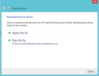

I followed the steps listed. My computer is up to date. The driver is up to date. I've deleted and reinstalled the driver. The driver is enabled.
I used the audio troubleshooting tool and got this:
Is it possible for the driver to have a problem, but still get sound sometimes? I can hear videos for a minute or two, but rarely does it last longer than that now. Can I use an external sound card? What can I do that doesn't involve replacing the computer?
@0rion
Thank you for posting back.
I appreciate your efforts to try and resolve the issue. To get the answer to this question, Yes! it looks like an audio driver related issue.
However, we can try a few more troubleshooting steps to isolate the issue.
