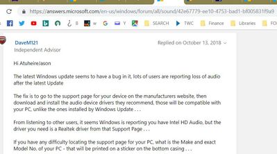

I upgraded from Win 8.1 to Win 10  a few months ago. Microsoft damaged the rear audio output function. It is very faint and unusable.  I think it was damaged in their automatic update. I reported the problem to Microsoft. Microsoft said that huge numbers of people had complained about it and they have people working on it. It has been several months and I never saw an update. I had hoped it would be automatic. I had paid over $100 to upgrade to Windows 10.
I followed the HP troubleshooter instructions. It told me to cycle power, press F2, go to HP diagnostics for the AUDIO components.  There is no diagnostics for audio.  So this problem cannot be fixed.
P7-1500z C9D15AV#ABA
The best advice that I read elsewhere is that the microsoft update installed the wrong driver: go to the manufacturer, IDT. I don't see driver support on idt.com. Another post said that IDT was bought out and does not supply drivers any more. My PC says that I do have an IDT driver. 6.10.6491.0 , but I suspect it is the wrong driver.
Can HP get me the correct driver? I have been through the debuggers and lengthy advice many times and think I have already updated the driver three times in the last few months to no avail.
Be oblong and have your knees removed
IDT company does not supply drivers on IDT websiteIDT company does not supply drivers on IDT websitemicrosoft "help" forummicrosoft "help" forum
