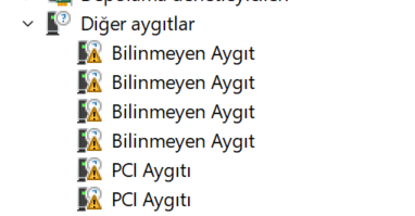

Hello,
Many drivers of my newly bought HP 240 14 inch G9 Notebook PC are not working.
Sound is not working. Touchpad not working.
I ask for your support
Serial Number: [Personal Information Removed]
Item Number : 6Q8M0ES#AB8

Hi:
Did you install the W11 drivers from your notebook's support page?
HP 240 14 inç G9 Dizüstü Bilgisayar Yazılım ve Sürücü İndirmeleri | HP® Müşteri Desteği
The chipset driver should install the smbus controller and perhaps some of those other devices as well.
Intel Chipset Installation Utility and Driver
target=_blankhttps://ftp.hp.com/pub/softpaq/sp142501-143000/sp142939.exe
Audio:
Realtek High-Definition (HD) Audio Driver - Alder Lake
target=_blankhttps://ftp.hp.com/pub/softpaq/sp142501-143000/sp142757.exe
Touchpad:
ELAN Precision Touchpad Filter Driver
target=_blankhttps://ftp.hp.com/pub/softpaq/sp136501-137000/sp136985.exe
Intel Dynamic Tuning Driver
target=_blankhttps://ftp.hp.com/pub/softpaq/sp136501-137000/sp136827.exe
Hi Paul_Tikkanen,
Thanks for your support.
Now I fix Realtek High-Definition (HD) Audio Driver - PCI Data Acquisition and Signal Processing Controller
SM Bus Controller.
But the most importtant device Touchpad is not work.
I need/waiting for your support...
in support page cloud recovery tool cannot identify my laptop...
Regards,
Burak...

Hi Paul,
Thank you so much for your help.
I was able to install the touchpad and other not found devices with the help of Driver Booster.
I was able to solve the last remaining pci error with your last suggestion/direction.
The problems are over.
Thank you very much.
Best Regards,
Burak
