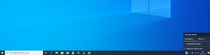

Sorry 4 my late response. You have to try launching the HP Audio Switch app  from the Start menu and then the following should appear above the system tray. (don´t be shocked, the system language is Czech 😉

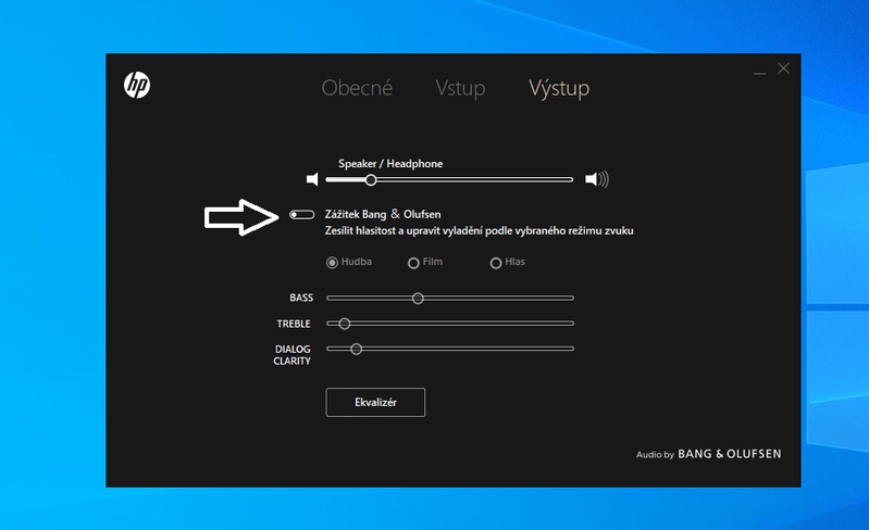

If not, I would bet that the driver update (or windows update) is responsible for your problem. If the given menu is displayed, then it is necessary to press the  button for setup setting and in the next step turn off the following on the output tab.
What I have found so far seems to me that the update always set this value for the headphones to state on = no bass. And unfortunately without the possibility to run the given settings where it can be turned off.

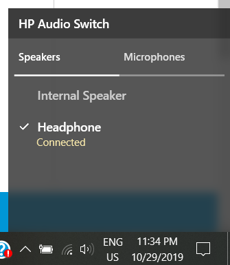

I found the audio switch but it doesn't have a settings option. How do I install the older versions of the app and driver? Is there an official HP link or something I can go to? I appreciate your offer to send the files but I'm not too comfortable with that. Thanks!
And which version of HP Audio Switch are u using now? I don´t know with which version you bought your laptop. But usually all of installed HP soft is saved in the SWSetup folder on system drive. If you have already updated this application I think that you can try to start HP Recovery Manager and select Reinstall drivers and/or application and choose what you need. But in a fact I have the option for setting in all versions of HP Audio Switch, so this is new to me.
