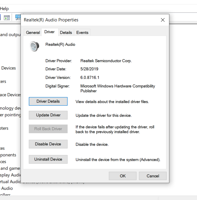

I'm currently addressing the same issue. After all the different uninstall and reinstall, only the following works for me now.
Unfortunately, the version of the audio driver 6.0.8716.1 Rev.C is still causing me problems (and of course the subsequent windows 10 updates). So I switched back to driver version 6.0.1.8454. Here is the fully functional HP Audio Switch (where you can open the settings of this utility and turn off the headphone extension on the Output tab). Sometimes I have to restart ntb. I think this is related to a known bug in Windows 10 1903. As you can read 4 example here.
You may be able to do this without reinstalling. I would try to open Device Manager - Audio, Video and Game Controllers - rclick on Realtek Audio - on the Driver tab, select Revert Driver Changes.
I hope it will help you.

10-29-2019 10:48 PM
I found the audio switch but it doesn't have a settings option. How do I install the older versions of the app and driver? Is there an official HP link or something I can go to? I appreciate your offer to send the files but I'm not too comfortable with that. Thanks!
