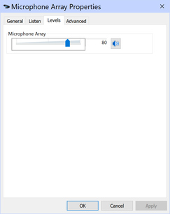

I did adjust the level, as suggested. Here’s a screen shot of my [Levels] tab:
