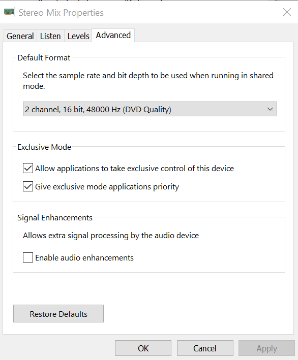

I have the same issue and have ran every test and updated every driver possible and still no luck. These are all of the steps I have taken:HP Support Status.pngLevels 100.pngMic Set to Default.pngMic Volume.pngNo Option to Configure.pngRealtek device working properly.pngSystem diagnostic.pngTS No Issues Found.pngWindows up to date.png16 bit.pngAudio Diagnostic.pngCan't test only TS.pngDevice Manager up to date.pngExclusive Access.png

KrazyToad!
The reset worked. Thanks very much!
